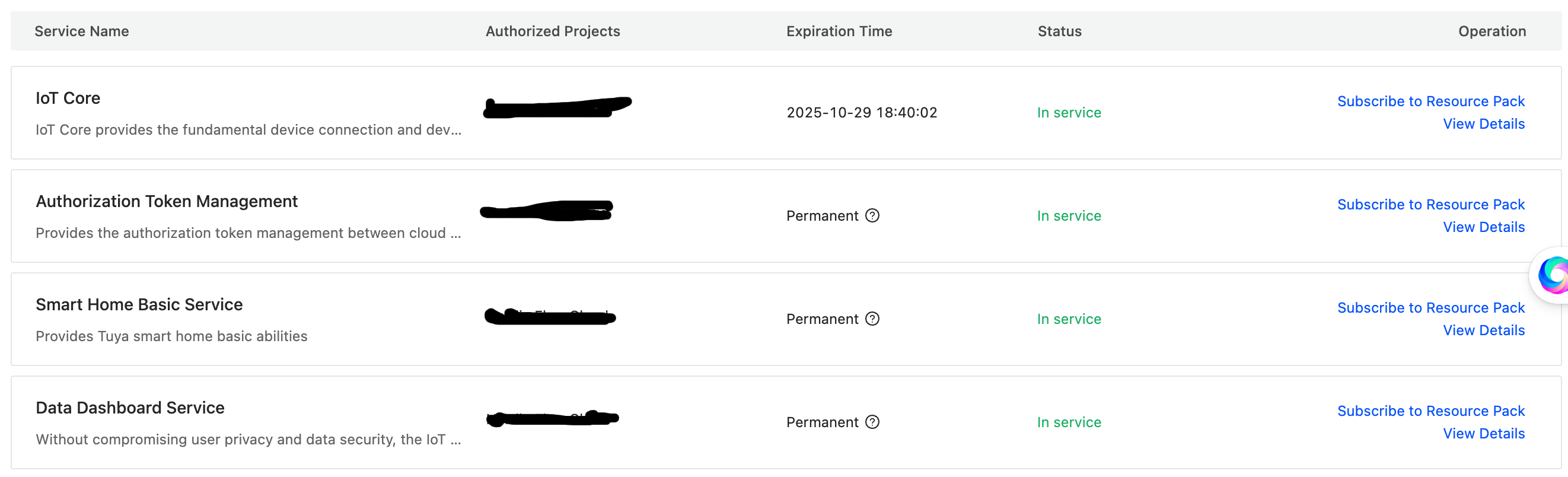

joseq32
Posts: 2
Re: Tuya Cloud - Link my app problem
Good morning, thanks for your reply. Yes my services are In service, check screenshot
