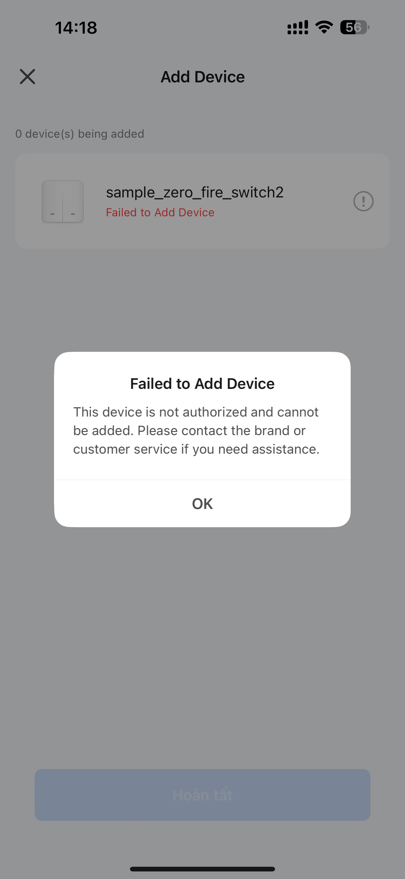

Currently, I’m migrating code from EFR32MG21A020_TuyaOS to NRF-ZIGBEE-SDK. When I try to add the device to the gateway, it can detect the device, but then an error occurs as shown in the image. I tried taking the IEEE Address from a ZS3L module running the demo from EFR32MG21A020_TuyaOS and using it for the custom code on the nRF52 module — in that case, the device was successfully registered and could be controlled properly.
Has anyone else encountered a similar issue?
