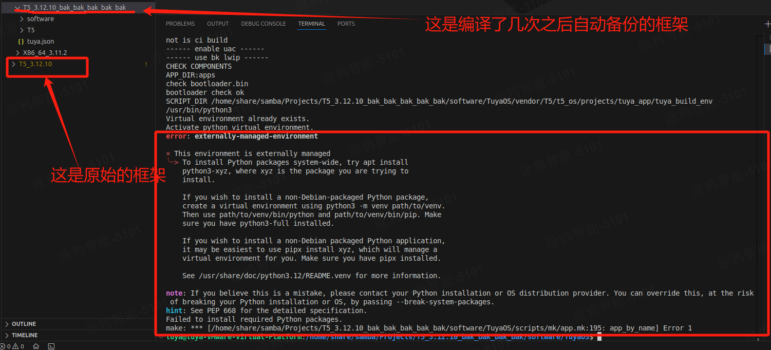

相同版本的框架,编译toy的demo就没问题,这有啥不一样吗? 编了gui的demo4次,工程名已经变成“t5_3.12.10_bak_bak_bak_bak”了

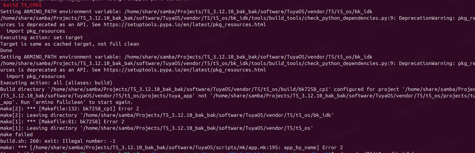

1、刚下载完3.12.10 SDK后直接一键编译GUI的开发包,会理解报告找不到路径,是因为工程被自动备份,且跳到备份的工程里编译了,工程名被改成了_bak,而编译指令的路径中不是——bak,所以找不到; 但是不知道为什么会自动备份

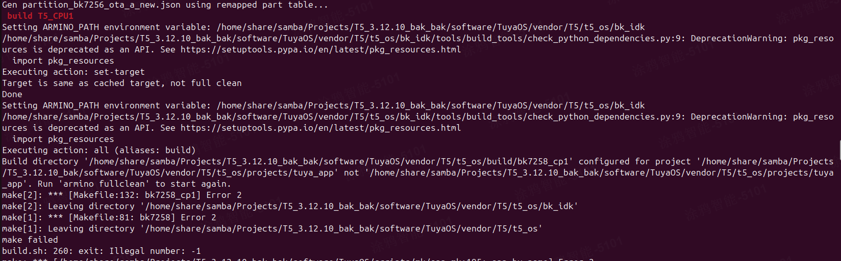

3、再次一键编译gui的开发包,此时会再次默认备份工程,跳到新备份的工程里编译,最终报错虚拟环境相关的, 我也做过一些尝试,比如删除虚拟环境手动创建再source激活,然后就会报告armino有问题,然后我再重装armino,还是有问题;
以下是其中几次报错,感觉就是一直备份导致路径不对了,

Executing action: all (aliases: build)
Build directory '/home/share/samba/Projects/T5_3.12.10/software/TuyaOS/vendor/T5/t5_os/build/bk7258_cp1' configured for project '/home/share/samba/Projects/T5_3.12.10_bak/software/TuyaOS/vendor/T5/t5_os/projects/tuya_app' not '/home/share/samba/Projects/T5_3.12.10/software/TuyaOS/vendor/T5/t5_os/projects/tuya_app'. Run 'armino fullclean' to start again.
make[2]: *** [Makefile:132: bk7258_cp1] Error 2
make[2]: Leaving directory '/home/share/samba/Projects/T5_3.12.10/software/TuyaOS/vendor/T5/t5_os/bk_idk'
make[1]: *** [Makefile:81: bk7258] Error 2
make[1]: Leaving directory '/home/share/samba/Projects/T5_3.12.10/software/TuyaOS/vendor/T5/t5_os'
make failed
build.sh: 260: exit: Illegal number: -1
make: *** [/home/share/samba/Projects/T5_3.12.10/software/TuyaOS/scripts/mk/app.mk:195: app_by_name] Error 2
