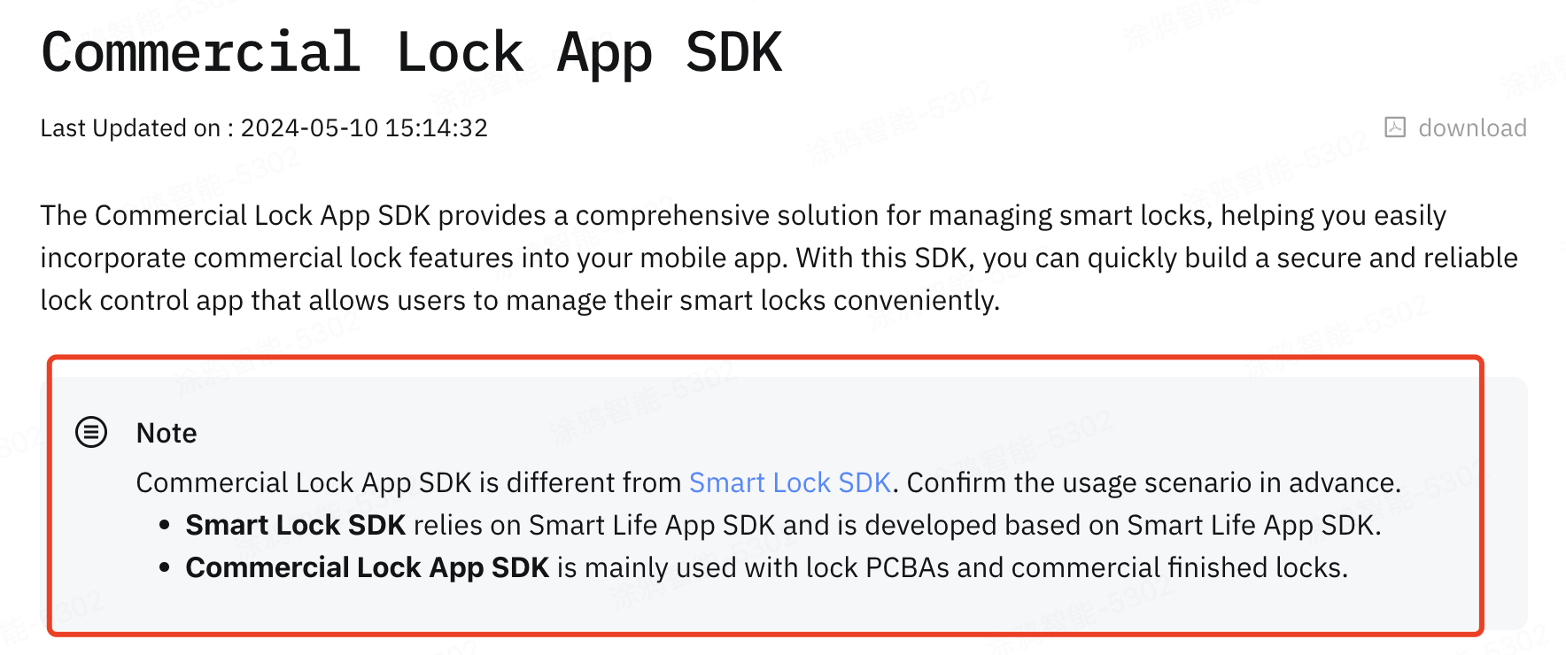

The first step is to make sure you are using the Commercial Lock App SDK, not the Smart Lock SDK.
For the difference between the two, please refer to the Note in the following link:
https://developer.tuya.com/en/docs/app- ... t175nsdh6i

1、Provide your deviceId. To obtain it, use the devId field of the ThingSmartDevice class. For reference, see:https://developer.tuya.com/en/docs/app- ... cgmmjr46cp.
2、Commercial Lock App SDK is mainly used with lock PCBAs and commercial finished locks. Requires enterprise whitelist authorization and SaaS support.
3、For common smart door lock device connection and control, use: Smart Life App SDK and Smart Lock SDK, refer to: https://developer.tuya.com/en/docs/app- ... vl28puletn

Hi abhi165, it seems you are using two different SDKs. Please confirm which SDK you need: ThingSmartLockKit (Smart Lock SDK) or ThingSmartLockSDK (Commercial Lock App SDK). Generally, we recommend using ThingSmartLockKit, as ThingSmartLockSDK is designed for commercial users.
