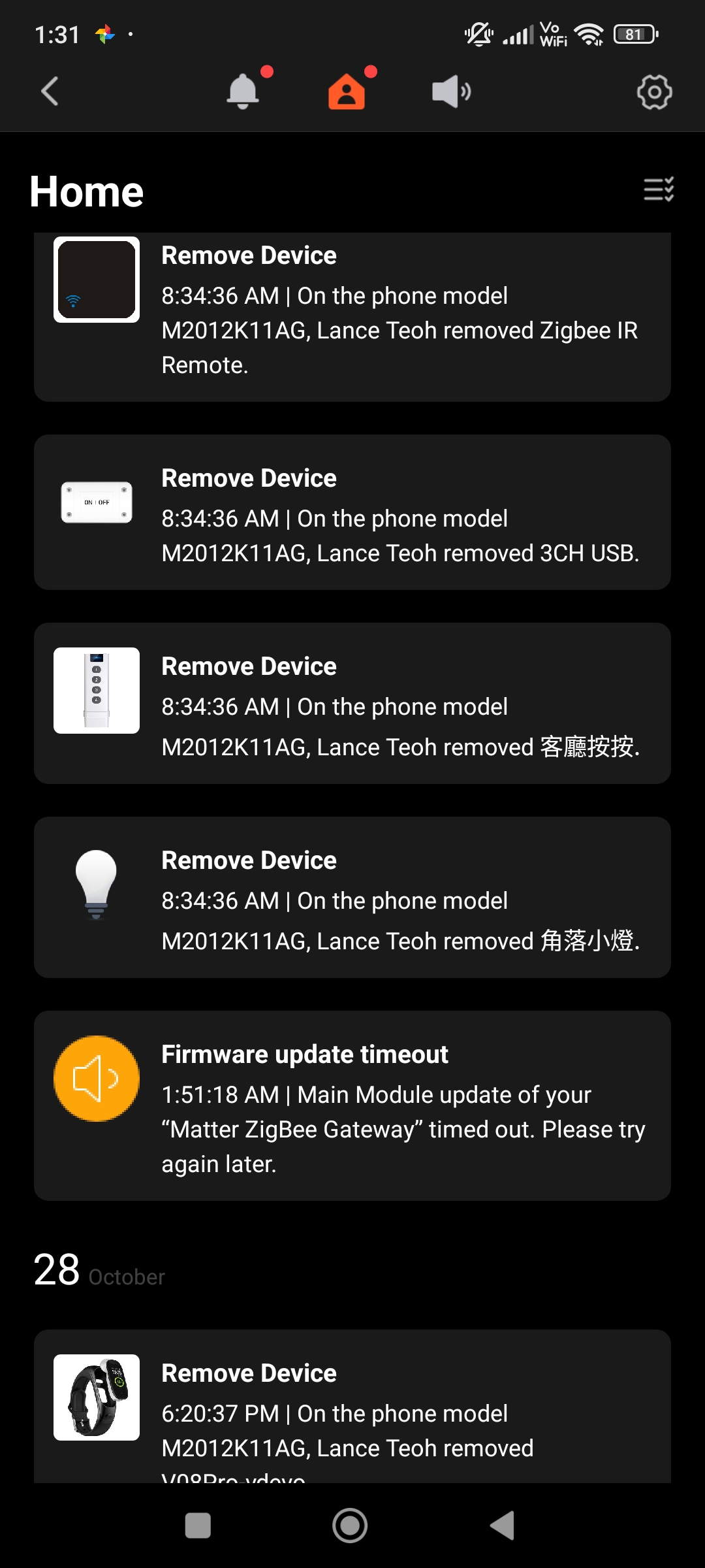

on 5th November, the update of firmware had timeout, and then I waited 7 hours hoping it can reboot properly by itself
timeout on 5th nov
timeout on 5th nov

We looked at the upgrade data online and found that most upgrades were successful, with only a few gateways experiencing issues after the upgrade.
After the upgrade, we observed anomalies in the gateways from the backend, but the cause is unknown. We have been trying to reproduce the issue locally but have not found the conditions to do so.
Could you please let us know where your gateway is? Would it be possible for you to send it to us for analysis? We can provide you with a replacement. Alternatively, who is your supplier?
