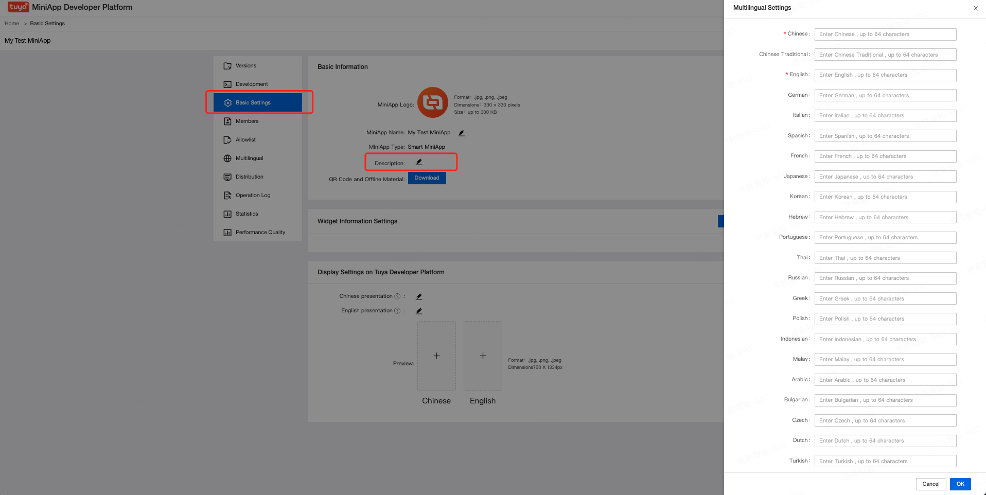

After reviewing the version I clicked on the release official version I had an issue "Mini app introduction must not be empty"
https://drive.google.com/file/d/1wbSbhn ... sp=sharing
Could you please help me to fix it
Posts: 444
Re: How to release miniApp
You can add a description of the MiniApp in this section, referring to the images in the attached document.
