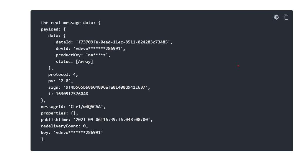

    => I can get real-time device log and show it in the console following the above tutorial.

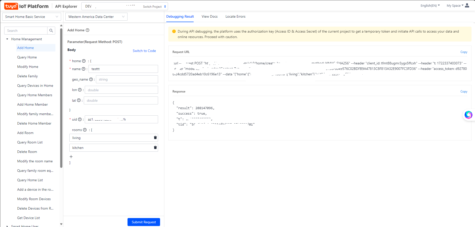

For now, I'd like to get log data when calling the "homeCreate" event of "Home event" using the above SDK
I follow the steps:
  • Run SDK

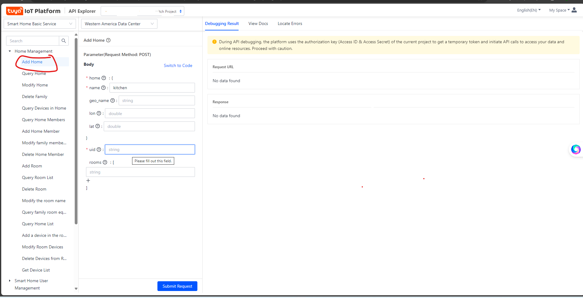

  • Call "add home" API
    => But I cannot see any log after executing API success
Please let me know, How to get log data for "createHome" event using Node.js SDK

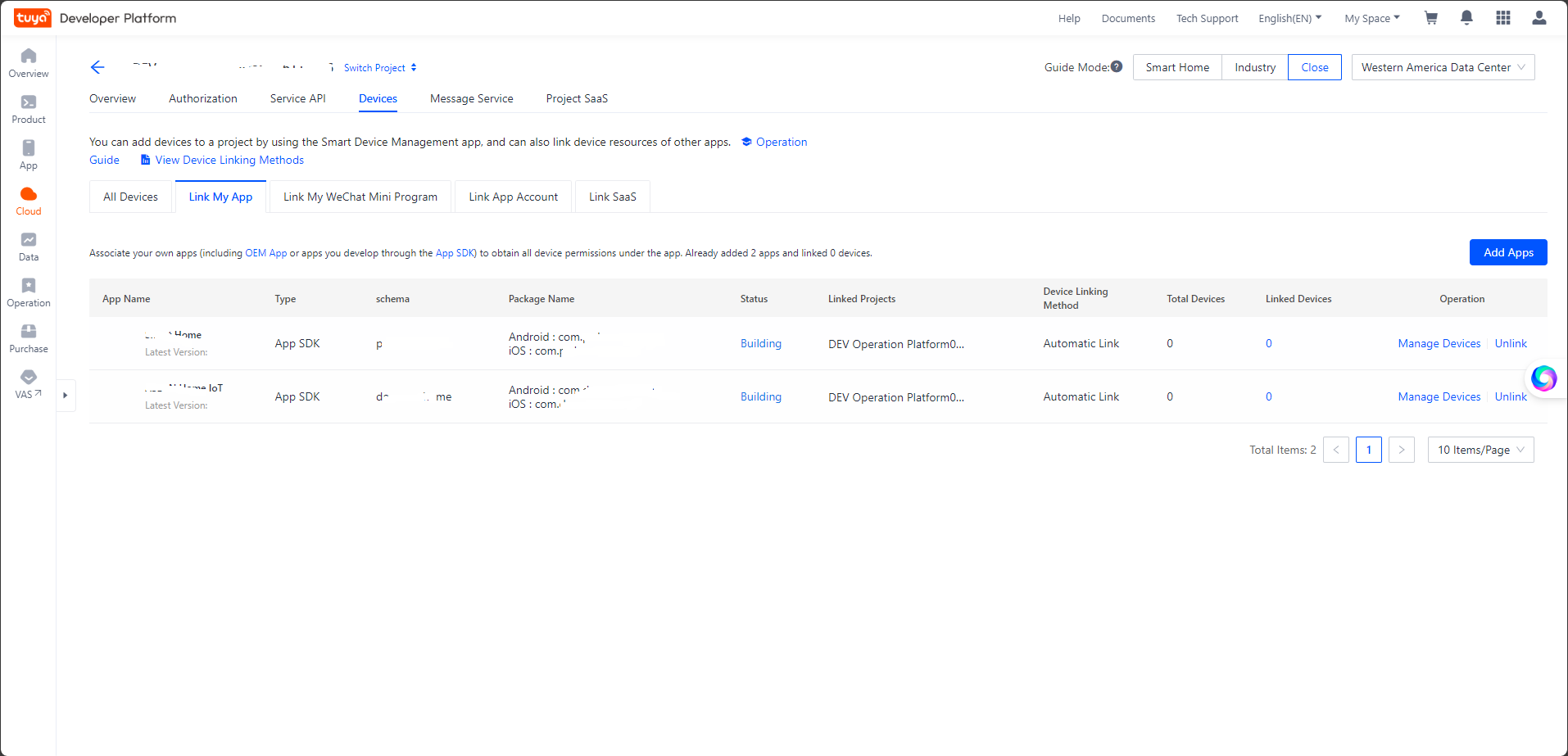

First, you need to subscribe to the "homeCreate" event in the project "Message Service", and then authorize the project with the uid account source app or uid of the home you want to create. For the authorization process, please refer to: https://developer.tuya.com/en/docs/iot/ ... 71nu1sfmkl. Finally, call the interface to create a home with the corresponding uid and you will receive the home creation message. (There will be a delay in data synchronization during the authorization process, so you need to wait a few minutes after authorization.)

  • Step 3: Call the interface to create a home -> execute API success

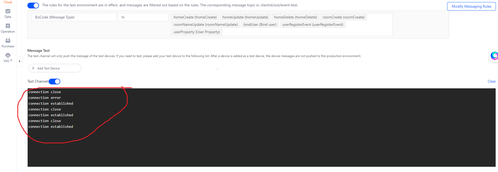

  • With env: TuyaWebsocket.env.TEST
    => I can only get the device log (online, offline, change status)

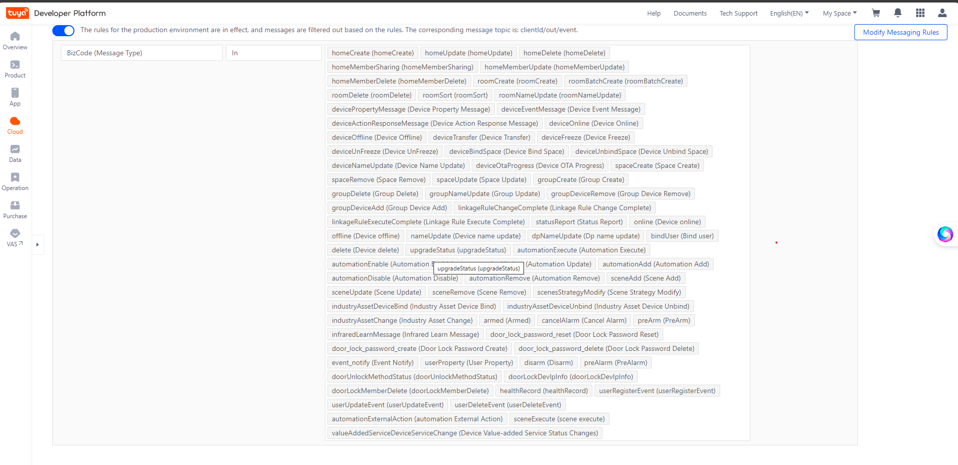

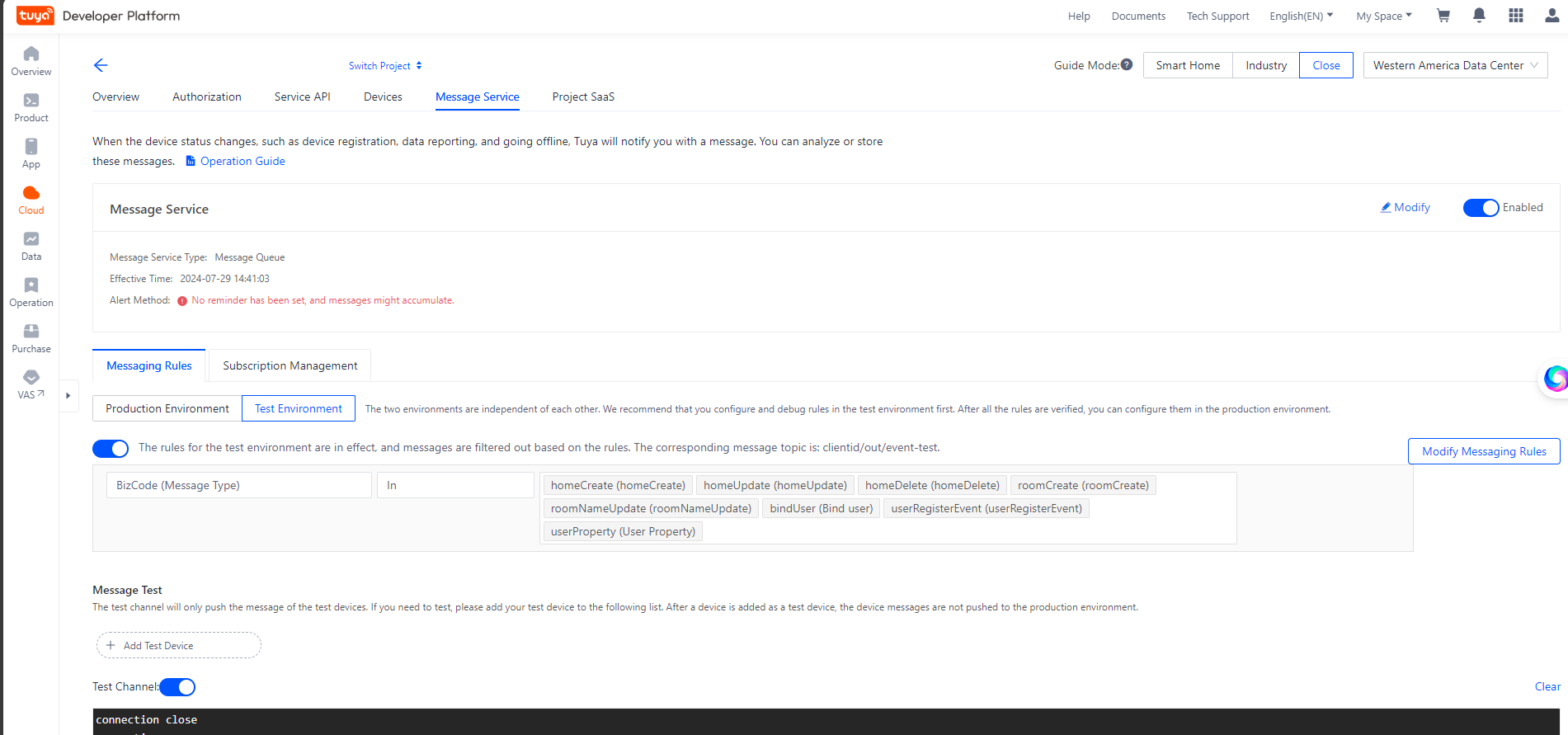

In the project's "Message Service -> Messaging Rules", you can turn off the "Test Environment", remove the configured test devices, and then enable only the "Production Environment" and subscribe to all the message types you need in it.

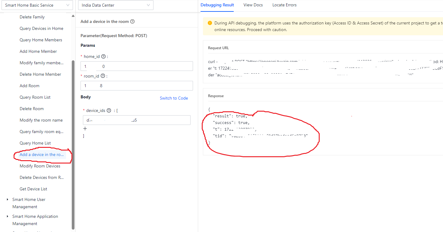

But with the "Add a device in the room" API, I cannot get the message log
I follow the steps:
  • Step 1: Subscribe to all the message types
  • Step 2: Call "Add a device in the room" API
=> After executing API successfully, I cannot see any message log in the console
Are the steps true?
Please let me know how to get the message log of "Add a device in the room" API
Thanks

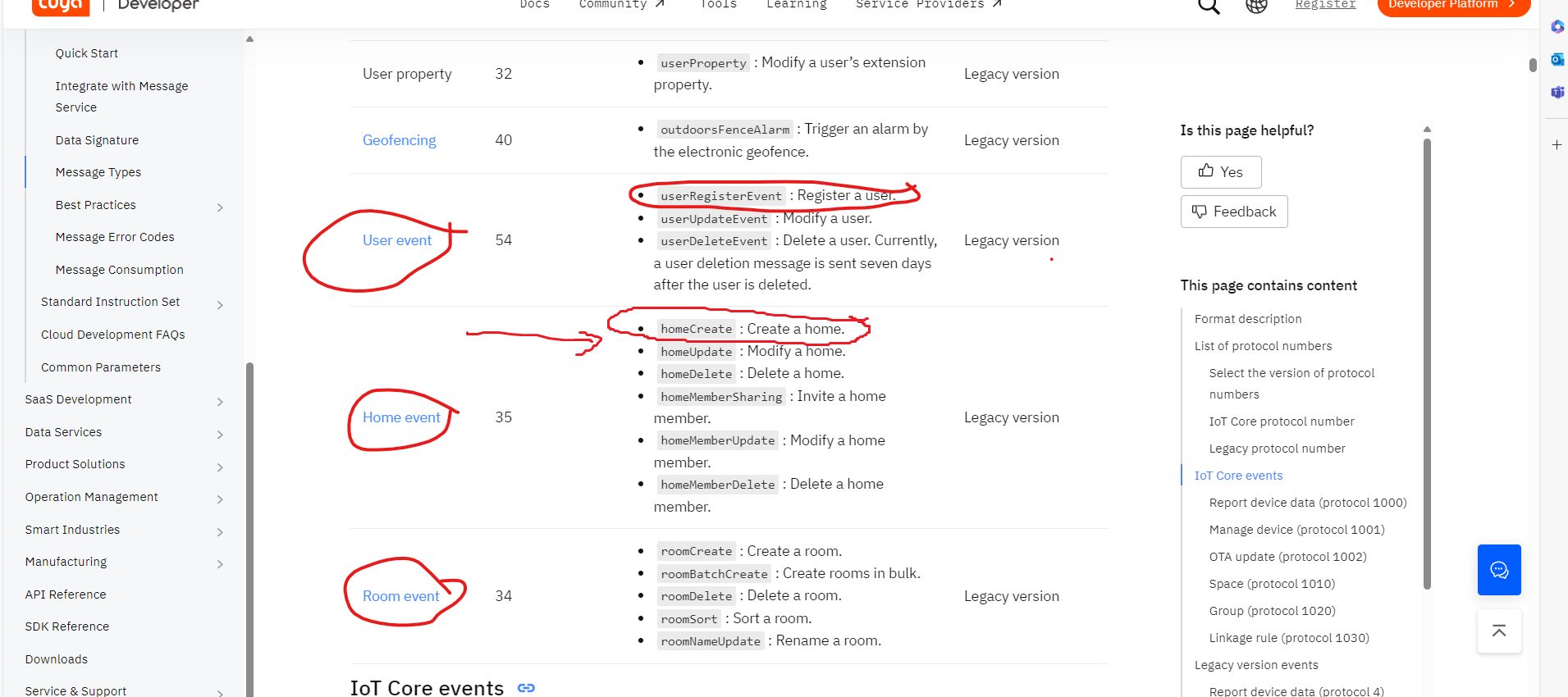

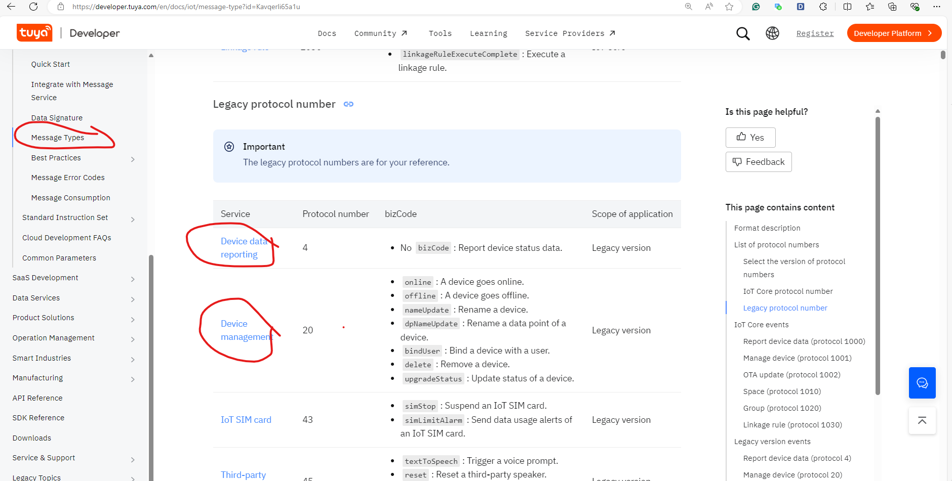

Sorry, there is no support for adding devices to the room so far. For specific supported message types, please refer to: https://developer.tuya.com/en/docs/iot/ ... qerli65a1u
