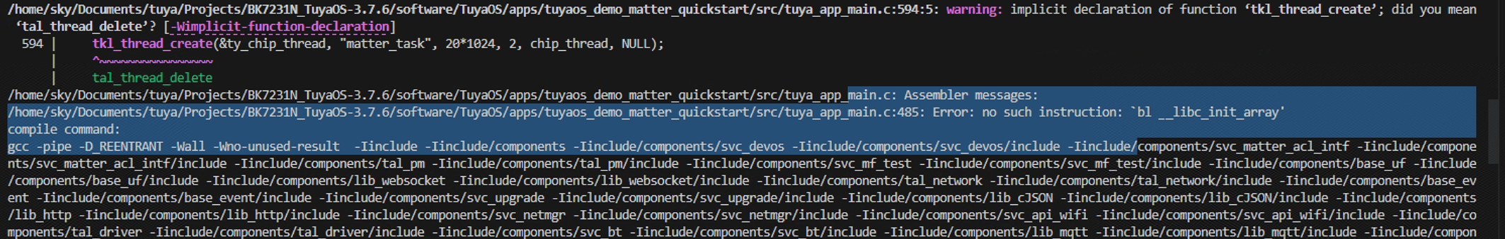

tuyaos_demo_matter_quickstart 的 demo 没有作任何修改,
环境为 vMbox- Ubuntu 22.04.3 LTS;
编译得到的的log 如下
/home/sky/Documents/tuya/Projects/BK7231N_TuyaOS-3.7.6/software/TuyaOS/apps/tuyaos_demo_matter_quickstart/src/tuya_app_main.c:594:5: warning: implicit declaration of function ‘tkl_thread_create’; did you mean ‘tal_thread_delete’? [-Wimplicit-function-declaration]
  594 |     tkl_thread_create(&ty_chip_thread, "matter_task", 20*1024, 2, chip_thread, NULL);
      |     tal_thread_delete
/home/sky/Documents/tuya/Projects/BK7231N_TuyaOS-3.7.6/software/TuyaOS/apps/tuyaos_demo_matter_quickstart/src/tuya_app_main.c: Assembler messages:
/home/sky/Documents/tuya/Projects/BK7231N_TuyaOS-3.7.6/software/TuyaOS/apps/tuyaos_demo_matter_quickstart/src/tuya_app_main.c:485: Error: no such instruction: `bl __libc_init_array'
compile command:
gcc -pipe -D_REENTRANT -Wall -Wno-unused-result  -Iinclude -Iinclude/components -Iinclude/components/svc_devos -Iinclude/components/svc_devos/include -Iinclude/components/svc_matter_acl_intf -

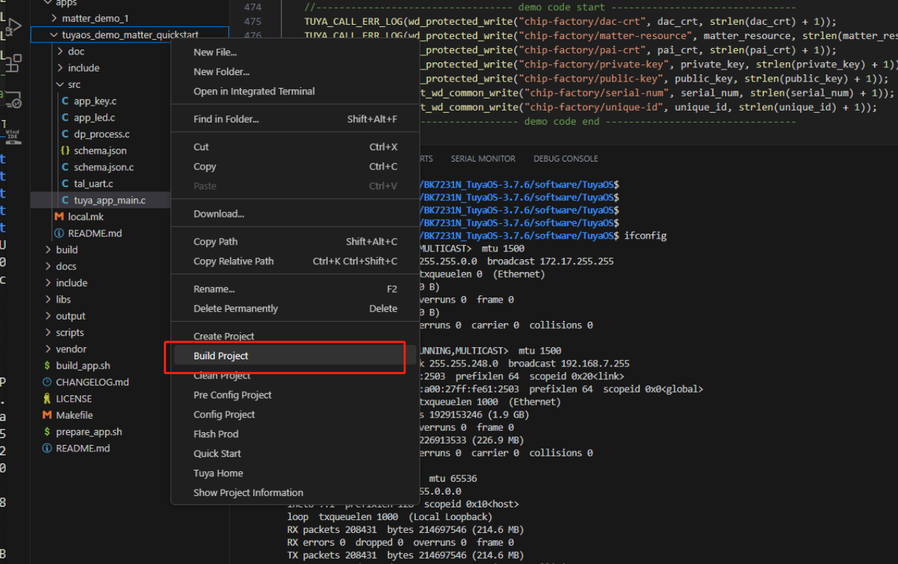

你用的是什么编译命令?用ide编译是没问题的?你用的是M1?

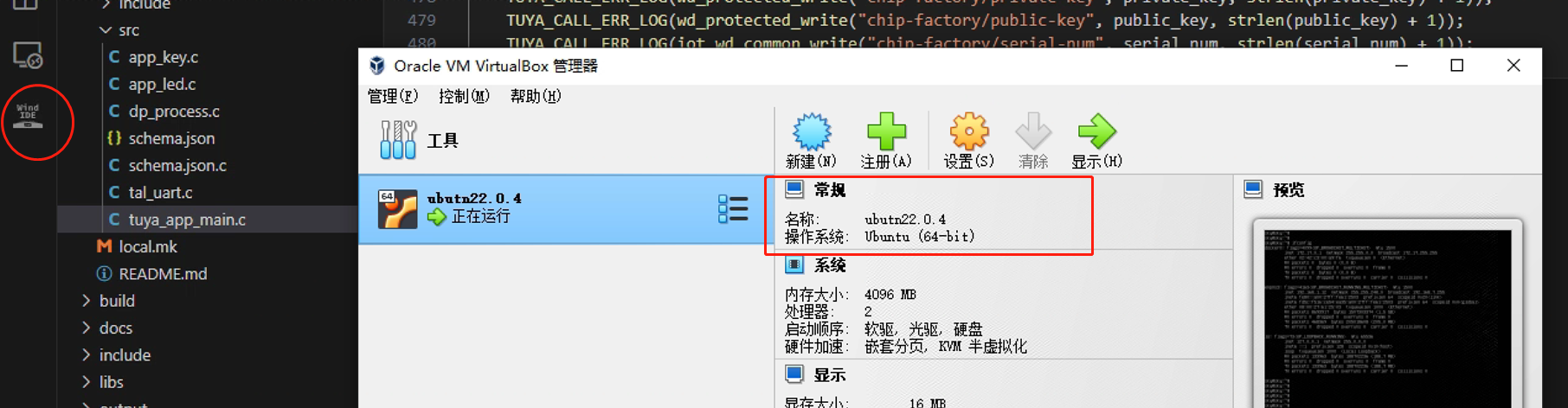

我是用VirtualBox 虚拟机, 系统是 Ubuntu22 也是按照 doc 网页哪里操作,提示 tuya_app_main.c:485: Error: no such instruction: `bl __libc_init_array' 是不是有些库没装好

:D 谢谢,我重新弄了个 ubuntu22.04的虚拟机可以了
