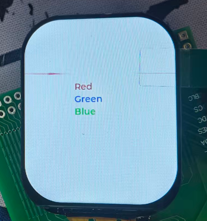

T5 LVGL输出颜色总是RBG,无论怎么调整绿色值总是再最后
Gzz_lin
Posts: 33
版本:T5_TUYAOS-3.12.12
问题1:颜色顺序通过驱动只能调整为RBG或者BRG,不知道为什么绿色值总是在最后,修改CONFIG_LV_COLOR_16_SWAP=y也没能解决,请问是要改什么配置或者什么初始化参数吗?
问题2:使用ai_toy例子配合自己的屏幕,滚动时严重闪屏。
请问需要改什么位置的或者什么参数?

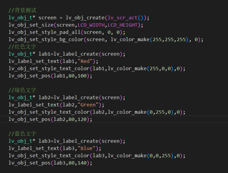

LVGL测试代码
 * @file tuya_app_main.c
 * @author www.tuya.com
 * @brief tuya_app_main module is used to
 * @version 0.1
 * @date 2022-10-28
 * @copyright Copyright (c) tuya.inc 2022
#include <stdlib.h>
#include "tuya_cloud_types.h"
#include "tuya_cloud_com_defs.h"
#include "tal_system.h"
#include "tal_log.h"
#include "tal_thread.h"
#include "tal_time_service.h"
#include "tkl_display.h"
#include "tkl_lvgl.h"
#include "lvgl/lvgl.h"
#include "tkl_thread.h"
#define LCD_IC_NAME "jd9853"
#define LCD_WIDTH 240
#define LCD_HEIGHT 296
STATIC TKL_THREAD_HANDLE sg_display_thrd_hdl = NULL;
STATIC THREAD_HANDLE ty_app_thread = NULL;
STATIC VOID_T __cpu0_recv_cb(UCHAR_T *buf, UINT_T len, VOID_T *args)
    // struct ipc_msg_s *send_msg = (struct ipc_msg_s *)buf;
// bk_printf("---> cpu0 ipc recv data cmd:0x%02x \r\n", send_msg->buf[0]);
void tuya_board_lcd_init(TKL_DISP_INFO_S *lcd)
lcd->ll_ctrl.power_ctrl_pin     = TUYA_GPIO_NUM_MAX;     // no lcd ldo
lcd->ll_ctrl.power_active_level = TUYA_GPIO_LEVEL_HIGH;
lcd->ll_ctrl.rgb_mode           = TKL_DISP_PIXEL_FMT_RGB565;
lcd->ll_ctrl.bl.io              = TUYA_GPIO_NUM_47;
lcd->ll_ctrl.bl.mode            = TKL_DISP_BL_GPIO;
lcd->ll_ctrl.bl.active_level    = TUYA_GPIO_LEVEL_HIGH;
lcd->ll_ctrl.dc_pin             = TUYA_GPIO_NUM_17;
lcd->ll_ctrl.dc_cmd_level       = TUYA_GPIO_LEVEL_LOW;
// lcd->ll_ctrl.spi.clk            = TUYA_GPIO_NUM_14;
// lcd->ll_ctrl.spi.csx            = TUYA_GPIO_NUM_19;
// lcd->ll_ctrl.spi.sda            = TUYA_GPIO_NUM_16;
// lcd->ll_ctrl.spi.rst_mode       = TKL_DISP_GPIO_RESET;
// lcd->ll_ctrl.spi.rst            = TUYA_GPIO_NUM_MAX;
lcd->ll_ctrl.tp.tp_i2c_clk      = TUYA_GPIO_NUM_MAX;
lcd->ll_ctrl.tp.tp_i2c_sda      = TUYA_GPIO_NUM_MAX;
lcd->ll_ctrl.tp.tp_rst          = TUYA_GPIO_NUM_MAX;
lcd->ll_ctrl.tp.tp_intr         = TUYA_GPIO_NUM_MAX;
lcd->ll_ctrl.rst_pin            = TUYA_GPIO_NUM_18;
lcd->ll_ctrl.rst_active_level   = TUYA_GPIO_LEVEL_LOW;
lcd->ll_ctrl.spi_using_qspi=FALSE;
STATIC VOID_T tuya_app_thread(VOID_T *arg)
    TY_INIT_PARAMS_S init_param = {0};
    init_param.init_db = TRUE;
    strcpy(init_param.sys_env, TARGET_PLATFORM);
    tuya_iot_init_params(NULL, &init_param);
    tal_log_set_manage_attr(TAL_LOG_LEVEL_DEBUG);
/*测试开始 */
TKL_DISP_DEVICE_S sg_lvgl_lcd;
TKL_DISP_INFO_S sg_lvgl_info;
TAL_PR_DEBUG("test start!");
memset(&sg_lvgl_lcd, 0, sizeof(TKL_DISP_DEVICE_S));
memset(&sg_lvgl_info, 0, sizeof(TKL_DISP_INFO_S));
sg_lvgl_info.width      = LCD_WIDTH;
sg_lvgl_info.height     = LCD_HEIGHT;
sg_lvgl_info.fps        = 20;
sg_lvgl_info.rotation   = TKL_DISP_ROTATION_0;
// sg_lvgl_info.format     = TKL_DISP_PIXEL_FMT_RGB565;
sg_lvgl_info.ll_ctrl.enable_lcd_pipeline = 1; // lvgl : 1, dvp:0
snprintf(sg_lvgl_info.ll_ctrl.ic_name, IC_NAME_LENGTH, "%s", LCD_IC_NAME);//"ili9488"
sg_lvgl_lcd.device_info = &sg_lvgl_info;
TAL_PR_DEBUG("============lcd init!");
tuya_board_lcd_init(&sg_lvgl_info);
sg_lvgl_info.ll_ctrl.type = TUYA_LCD_TYPE_SPI;
TAL_PR_DEBUG("============display init!");
tkl_disp_init(&sg_lvgl_lcd, NULL);
TKL_LVGL_CFG_T lv_cfg = {
    .recv_cb = __cpu0_recv_cb,
    .recv_arg = NULL,
TAL_PR_DEBUG("============lvgl_init!");
tkl_lvgl_init(&sg_lvgl_info, &lv_cfg);
TAL_PR_DEBUG("============lvgl start!");
tkl_lvgl_start();
TAL_PR_DEBUG("============set bl!");
tkl_disp_set_brightness(NULL, 100);
while(1)
    TAL_PR_DEBUG("============display init done!");
    tal_system_sleep(1000);
/*测试结束 */
tal_thread_delete(ty_app_thread);
VOID_T tuya_app_main(VOID)
#if defined(ENABLE_EXT_RAM) && (ENABLE_EXT_RAM == 1)
    extern VOID_T tkl_system_psram_malloc_force_set(BOOL_T enable);
    tkl_system_psram_malloc_force_set(TRUE);
#endif
THREAD_CFG_T thrd_param = {10240, 4, "tuya_app_main"};
tal_thread_create_and_start(&ty_app_thread, NULL, NULL, tuya_app_thread, NULL, &thrd_param);
void tuya_gui_pause(void)
    //! TODO:
void tuya_gui_resume(void)
    //! TODO:
STATIC VOID_T __cpu1_recv_cb(UCHAR_T *buf, UINT_T len, VOID_T *args)
} STATIC VOID_T __lv_draw() { lv_obj_t* screen = lv_obj_create(lv_scr_act()); lv_obj_set_size(screen,LCD_WIDTH,LCD_HEIGHT); lv_obj_set_style_pad_all(screen, 0, 0); lv_obj_set_style_bg_color(screen, lv_color_hex(0xFFFFFF), 0); lv_obj_t* lab1=lv_label_create(screen); lv_label_set_text(lab1,"hello world"); lv_obj_set_pos(lab1,10,100); lv_obj_t* obj = lv_obj_create(screen); lv_obj_set_size(obj,20,20); lv_obj_set_style_bg_color(obj,lv_color_hex(0xFF0000),0); lv_obj_set_pos(obj,100,100); lv_obj_t* obj2 = lv_obj_create(screen); lv_obj_set_size(obj2,20,20); lv_obj_set_style_bg_color(obj2,lv_color_hex(0x00FF00),0); lv_obj_set_pos(obj2,120,100); lv_obj_t* obj3 = lv_obj_create(screen); lv_obj_set_size(obj3,20,20); lv_obj_set_style_bg_color(obj3,lv_color_hex(0x0000FF),0); lv_obj_set_pos(obj3,140,100); } STATIC VOID_T __tuya_ai_display_thread(VOID_T *arg) { // TY_DISPLAY_MSG_T disp_msg; // OPERATE_RET rt = OPRT_OK; __lv_draw();
for (;;) { // rt = tkl_queue_fetch(disp_msg_queue, &disp_msg, TKL_QUEUE_WAIT_FROEVER); lv_vendor_disp_lock(); // tuya_ui_app(&disp_msg); lv_vendor_disp_unlock(); // if (disp_msg.data && disp_msg.len) { // tkl_system_psram_free(disp_msg.data); // } } } VOID_T tuya_gui_main(VOID_T) { TKL_DISP_INFO_S info; info.width = LCD_WIDTH; info.height = LCD_HEIGHT; // info.format = TKL_DISP_PIXEL_FMT_RGB565; info.fps = 20; info.rotation = TKL_DISP_ROTATION_0; snprintf(info.ll_ctrl.ic_name, IC_NAME_LENGTH, "%s", LCD_IC_NAME); TKL_LVGL_CFG_T lv_cfg = { .recv_cb = __cpu1_recv_cb, .recv_arg = NULL, }; tkl_lvgl_init(&info, &lv_cfg); if (NULL == sg_display_thrd_hdl) { tkl_thread_create_in_psram(&sg_display_thrd_hdl, "ai_display", 1024*6, 4, __tuya_ai_display_thread, NULL); }
} #endif

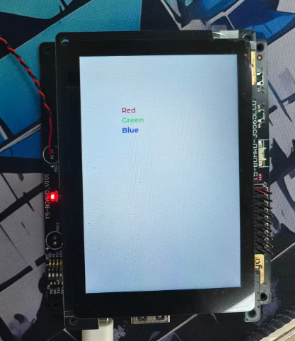

同样的代码在开发板自带的屏幕上是正常的。
我的屏幕是spi屏幕,自己写的屏幕驱动,工程用的是tuyaos_demo_quickstart复制创建的,并且参照ai_toy配置了
CONFIG_LCD_SPI_DISPLAY=y
CONFIG_ENABLE_TUYA_UI=y
CONFIG_T5AI_BOARD=y
有可能出现问题的地方:
1、屏幕驱动参数,我使用51开发板进行了一次验证,是正常的。
2、SDK配置问题
3、LCD_SPI底层库驱动有问题

void main()
lcd_init();
while(1)
	lcd_fill(0,0,240,296,0xFFFF);//白
	lcd_fill(0,0,240,296,0x0000);//黑
	lcd_fill(0,0,240,296,0xF800);//红
	lcd_fill(0,0,240,296,0x07E0);//绿
	lcd_fill(0,0,240,296,0x001F);//蓝

Gzz_lin
Posts: 33
Re: T5 LVGL输出颜色总是RBG,无论怎么调整绿色值总是再最后
咨询屏幕厂商称屏幕驱动芯片不存在RBG或者BRG的格式,就算是屏幕的驱动参数配置错误也绝不可能出现这种情况。
Gzz_lin
Posts: 33
解决了,用tuyaos_demo_quickstart创建的项目,自行编写tuya_app.config也需要make生成tuya_app_config.h并引用才能生效
