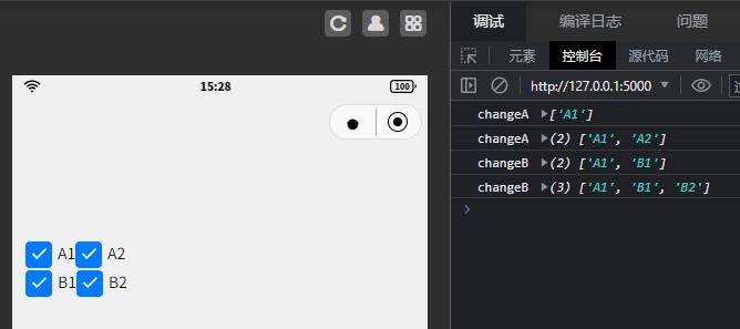

依次点击A1,A2,B1,B2后,控制台输出:
changeA ['A1']
changeA ['A1', 'A2']
changeB ['A1', 'B1']
changeB ['A1', 'B1', 'B2']
预期应该输出:
changeA ['A1']
changeB ['B1']
changeB ['B1', 'B2']

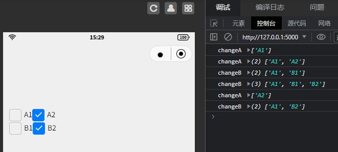

继续上面的操作,四个全部选中的状态下,依次取消A1,B1的勾选,控制台输出:
changeA ['A2'] // 取消A1后触发,此时界面上选中项为A2,B1,B2
changeB ['A1', 'B2'] // 取消B1后触发,此时界面上选中项为A2,B2
预期应该输出:
changeA ['A2']
changeB ['B2']
