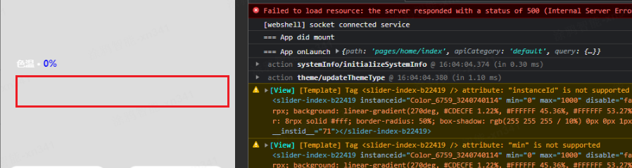

滑动条组件不显示滑动条
专业搬砖
Posts: 9
滑动条不显示,这个是yarn.lock文件和package.json文件,代码是组件库原封不动的代码。
17044198780e247ac90dd (1).zip
(255.38 KiB) Downloaded 476 times

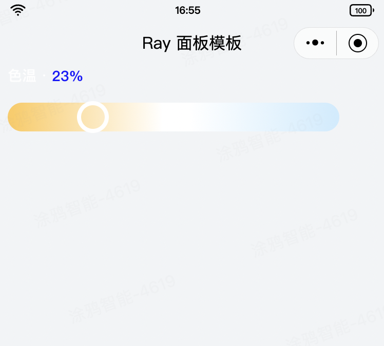

Re: 滑动条组件不显示滑动条
import React, { useState } from 'react';
import OpacitySlider from '@ray-js/lamp-style-slider';
export function Home() {
  const [value, setValue] = useState(1000);
  const handleMove = v => {
    // console.log('move====', v);
  return (
    <OpacitySlider
      style={{
        paddingLeft: 16,
      label="色温"
      valueStyle={{ color: 'blue' }}
      disable={false}
      value={value}
      onTouchMove={handleMove}
      trackBackgroundColor="linear-gradient(270deg, #CDECFE 1.22%, #FFFFFF 45.36%, #FFFFFF 53.27%, #FFCA5C 98.32%)"
export default Home;
"@ray-js/components-ty-lamp": "1.10.3",
我试了一下是正常的
